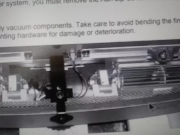

Hmmm would you happen to have a pic...
(broken link removed to http://www.chimneysweeponline.com/hsmanualclydesdale.pdf)
Page page 28 of 33

I think this is what your referring to
C 34 7000-301 SWITCH: T'STAT,BLOWER,TUC 1/WIN/DVI 32

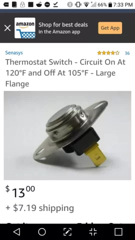

Yes 21500 F120-15F 7000-3
I do not know what your temps are but the numbers MAY indicate NC (on) at/above 125*f and NO (off) below 105*f
Amazon product ASIN B0026RTEZC[Hearth.com] Clydesdale wood insert thermostat .. replacement ?
Youll find it cheaper if you shop around AND *** The switch MUST be rated for the voltage used, Presumably 120V***
11.95 fs over 25
Yes, that is right for temperature. It must be rated for the amperage load of the blower(s). They come in different packages. Some are button faced like the one you posted and some are flush-faced. That will be easy to determine when it's removed.
