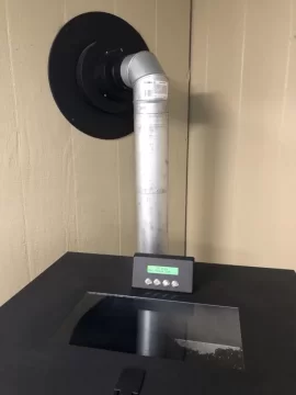

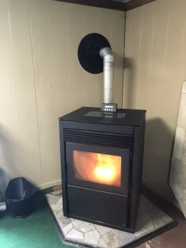

Who would have thought it possible.

Is this a DS Stove prototype? Not listed on their site. Facebook link is worthless.
Very nice.
It’s the prototype. They’ve been building this for years it seems. There’s a group of dealers burning them this winter. They made 50. So far very nice. Everything is stepped down to 24 v DC. Very hot and very efficient. Are you familiar with DS?
A bit, but not much. I am wondering how long pellet vent pipe will stand up under the corrosive fumes of coal burning and whether any pipe manufacturer has approved of it for this use.
It actually is recommended with the Ultimate One DV Pellet Vent. But it is approved for P Vent. I also wonder about the pipe over a few years.

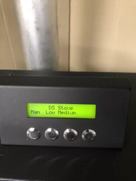

How noisy is it? Is the stove constructed similar to a pellet stove but for pea coal? That is, does it have a combustion and convection fan system?

It has a double reburn system. It also has a combustion fan, convection fan and a exhaust “helper fan” if the stove senses the exhaust flow is low. It’s fairly quiet but a little louder on the med high and high setting. It does throw a lot of heat.
