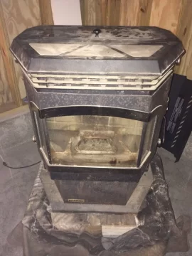

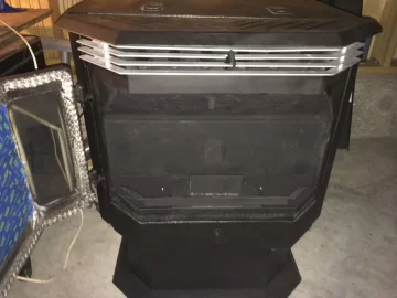

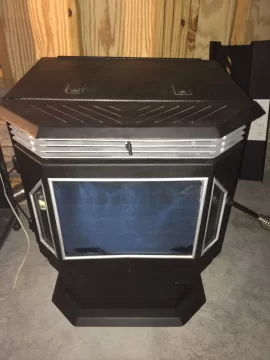

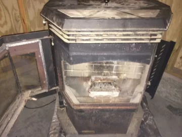

I have a very similar problem! Putting a Pellet Stove in my new workshop!
Should I install this nice new looking Englander 25-EP same as the 55-TREPEP I also have new fire brick backing for it.
Or
This dirty old Harman Advance. I also have a Brand New Nickel Trim Kit for it.
Price is not too much of an issue here, I own both stoves. I like to have extra stoves around for fun. :)
What would you do?
Pic 1-2 Englander
Pic 3-4 Harman Advance
Click pics to Enlarge.

It's a shop - put in the dirty stove and leave the nice looking one for your new solarium that your SO will want in exchange for the new workshop :)
Reactions: Don2222
