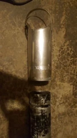

hi there, I have a free standing stove that I want to vent up through a masonary chimney. bought a forever flex 4in stainless liner. is there and adapter to connect the smooth clean out tee to double pl vent

Go here to see some samples of what you need.
Your pellet vent manufacturer will have the correct adapter(s)...
(broken link removed to http://duravent.com/docs/product/PelletVent_Pro_Catalog_Section_2016.pdf)
Go to page 9.

I think those are just to connect to the liner itself and not the take off snout
