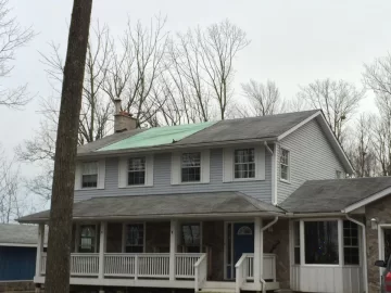

Well update again boys and girls! Not that I'm a huge fan of getting on this roof but I get on to do chimneys. All tarped. While I was up there cleaned furnace chimney down. 1 cup of sote not bad.
Had 2 contractors come today. Both much more professional! Just need to decide on who to go with. Gonna cost close to 10g's but that's everything top of the line, damaged blown in took out and replace and whole attic topped up to r60. Can't wait and very glad to not have to do it myself. I will post a pic when done. Thanks all for your help. Felt like a crisis.
On a side note like I said decently ok with getting on this top roof. Today for some reason almost felt shy of a panic attack when I got up there and I'm usually good with heights. Had to sit down for a few and collect myself. Note to all be very safe when on your roof, not worth getting hurt. Makes me glad to upgrade whole roof and get a new high efficiency furnace next year and only have to clean chimneys once in summer off neighbours Sky lift

Second floor roof with farmers porch, definitely worth paying someone you trustto do it. Lugging shingles up two storys on a ladder if you are not used to it is lot harder than it looks especially on a warm day
