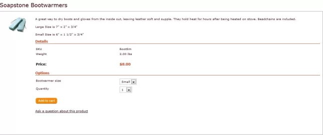

This is what we use under the pots and pans. They have double or triple use! We use them for cooking. For drying gloves and boots. I also take a pair to the woods with me inside an extra pair of gloves. Feels great when the hands get cold and/or wet. Put on a pair of nice warm gloves then feels great!

Huh, this seems near perfect for us. Mostly because it's $10. :)
Huh, these are cheap as well. :) I've never seen these before. Do they get hot enough to boil water in pans placed on them? And how long do they take to cool off?
Brad, we've never boiled water but do lots and lots of cooking. That is, most every day in winter something is on the stove.
How long before they cool off certainly will be dependent upon where they are. Put them on the cold sidewalk and I doubt they will hold heat long. Go cutting wood for 2-3 or more hours and they will still be too hot to handle. Put them inside a wet pair of boots and I don't know. We just leave them overnight. Same with wet gloves, but most times with the gloves we just lay them directly under the stove and they dry very well and quite fast.
I should have added that as a little boy I remember using the old soapstone a lot. We used it in the car, on the floor to keep the feet warm. Used it for a foot warmer in the bed, etc. Wonderful things they are.
