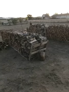

I haven't checked moisture content since I cut and split the pine at the beginning of summer but I'm confident it's good to go. I have about 1 cord of juniper/elm/citrus mix left over from last winter that is plenty dry.
edit- I burn whatever I can get for free

Moisture meters are cheap. Many people feel there wood is good and its not. Its better to check and make sure.. know its good and rule the wood out as a variable that may be making the stove running not as optimal as it could..
I have a moisture meter, just haven't checked my newest inventory yet.
The wood (I burned) left over from last year is 15%
Explain you're procedure for using your moisture meter.
Grab a split log, split it further and test with meter prongs going parallel to the grain.
I will test at 2-3 places on the log and test 2-4 logs from different places in the stack.
Furthermore, I just tested a few older pieces left over from last winter and some newer pine from this summer and my meter shows some at 10% and some at a big ZERO moisture..... hmmmm ?
My meter registers when I touch it and if I dip it in soil so It seems to be working
