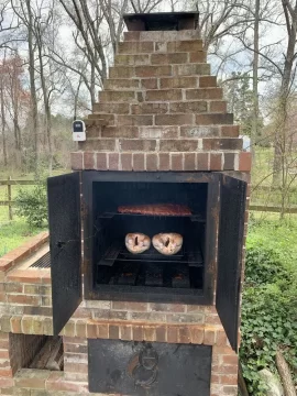

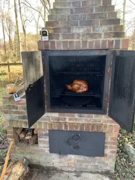

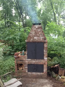

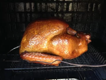

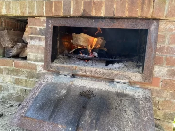

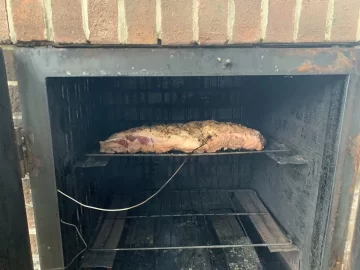

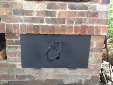

On my brick smoker, I built this about 8 years ago. A year or so ago, I hit the inside with a wire brush to clean it. I mostly burn pecan, apple, peach, maple or persimmon. Once coals are established I burn one split, and set the next split on the opposite side of the fire box to warm. This helps with reducing the harsh tasting smoke when adding the new split if it is already very warm.

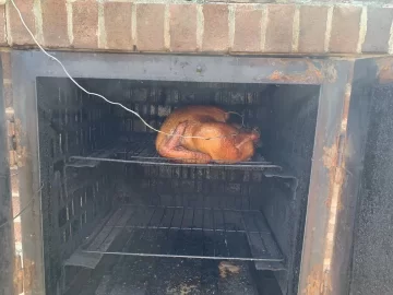

Does this seem like creosote or smokey goodness plastered all over the walls of the cook chamber?
I can scrape/wire brush it more often, but I don’t think I’ll ever get it clean.
I used to use it like an outdoor fireplace and sit out by it in the evenings with the firebox open, which would have a more robust flame. Nowadays I just cook briskets and Thanksgiving Turkey. Typically, there is some fire on start up, a little when a new split is added, but mostly, it’s a coal bed with some smaller flames below the cast iron baffle under the food. There are lots of charred drippings under the food on the cast and fire brick.

I always assumed it was just smokey goodness on the walls, but every once in a while I do look at it and think to myself….is this think gonna go up in flames one day?
My brother did have an offset metal smoker go up on him one day when he left the cook lid open when he took the food inside. He came back out to a ball of fire on his back porch, shut it down and closed it all up and it snuffed itself out. He may have had a pool of fresh pork butt grease in the bottom too.
