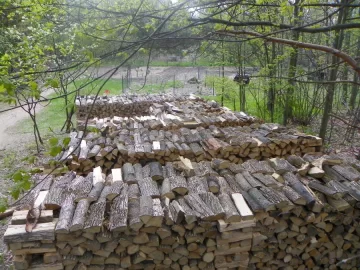

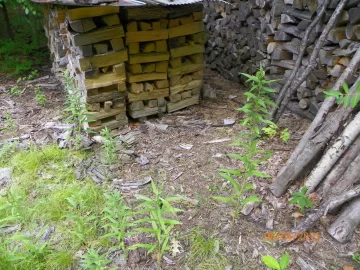

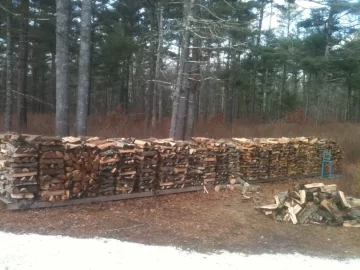

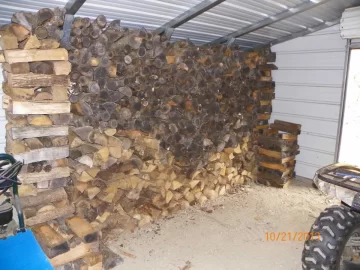

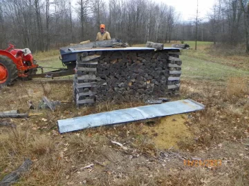

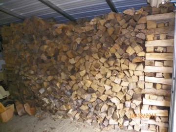

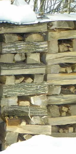

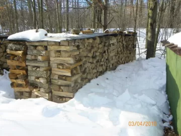

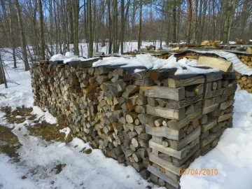

There is no secret. Just build it solid. Notice the first picture does not look too solid but it stood for 4 years with no problem. Picture 2 shows a close up. Notice that we do tend to split a lot of our splits in rectangles which does work really well for the ends. Picture 3 shows a neighbor who came after some wood. That stack was 3 years old and still solid. The last picture is a stack that was built in April of 2009. It still stands today and will be burned next winter.
One thing we do is stop stacking when it gets to be approximately 4 1/2' high. Any higher and it seems lots of folks find themselves re-stacking at some point.

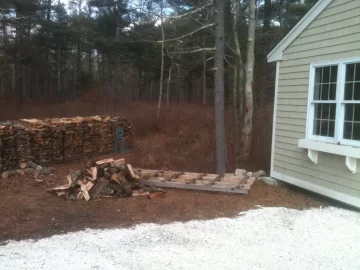

I have cross stacked 40'x4'x4' this winter to see if it dries faster or better. For the past 4 years I have just crossed the ends to hold it all together. I did 20' of oak and 20' of pine I need to take the time to learn how to post a picture here from my I-Pad because pictures tell it all :-)

Here's a pic. of my cross stacked oak and pine (20' of each). And another 12 pallet getting started.
