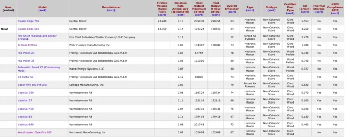

Can someone explain the 2020 EPA regulation to me? I just looked on their website for the OWB that complies with this and there are very few. With this regulation, does it mean that I would not be able to pick up a wood boiler if it doesn't meet these specs?
I understand that the MP unit is considered a coal unit and exempt from the EPA emissions, but if I wanted a Gassifier which is considered a wood unit, would I not be able to purchase it if it doesn't meet the 2020 regs?
Reactions: Terryl
The Crown Royal E series and Heatmaster G series both make the 2020 list. Looks like Central Boiler finally made the list.
The Multi Pass is coal or wood. The difference is commercial applications, over 2500 sq ft, are exempt also. Mine is hooked to my shop as commercial use and incidentally may be hooked to the house too. The other side is Indiana actually has wording to ban coal burning as a whole on hydronic heaters so you have to look hard at the local and state laws. A lot of areas have enacted stricter laws. Some require a permit to install and operate. Make sure you research all that.

Where are they on the 2020 list? I'm not seeing them. HeatMaster has 2020 compliant models coming but the current G series isn't legal for residential after May 15. Is Crown bringing on new units this spring?
From my reading of the NSPS, the definition of a commercial building is what it is used for, not sq ft. If a house is attached to the boiler then a commercial exemption doesn't apply.
I know there's been no enforcement by the EPA, so it's somewhat irrelevant, I'm just discussing for fun.

Listed under Greentech Manufacturing.
Looking at the EPA website, I am not seeing Crown Royal/ Greentech Manufacturing being 2020 compliant. I have a screenshot attached below of all the 2020 Approved Wood Boilers.
