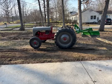

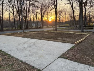

Yea there’s nothing important where it’s going thankfully so nothing to worry about on that front. Just scraped what little topsoil was there away for preparation of the delivery this afternoon
