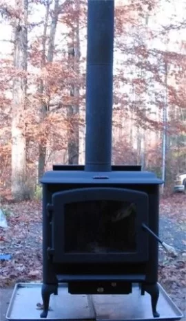

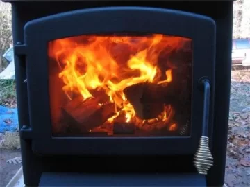

Sit it on the driveway, stick a couple of pipe sections in the top, put some wood in it and fire it up. Babying a steel stove in breakin isn't as critical as it is with a cast stove. The limited draft won't let you overfire it anyway and doing it outside will keep you from stinking up the house and setting off the smoke detectors as the paint cures.

BB, you are always so correct. My thoughts were for inside where he might get too much burn off; you are absolutely right that if you can burn it in outside, then go for it....
Thanks for the help. I have it installed already and can't move it out by myself so it will be death by a thousand little fires. Thanks to everyone for being so helpful.
