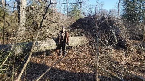

I agree with above.. I was cutting this weekend.. I cut alot of wood some being over 24inches.. ran right through it..
