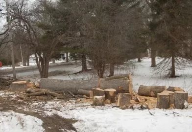

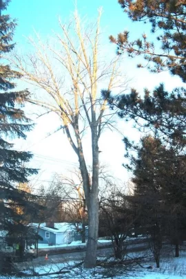

Here's a big ash currently sitting in my front yard. It's 35" on the butt and 33" at the top of the log. 650 board feet, more or less. I'm going to hack it up with a Jonsereds Model 90 with a 24-inch bar. My chain is filed to perfection (has to be on a log this big), but I just know I'm going to hit some metal at some point on my way down the trunk. The tree is 105 years old and grew right alongside one of the main roads out of town. I figure the whole tree has about 3 full cords. Hope to finish it up this weekend.
The power company was kind enough to cut it down at no charge, and left me the wood even though they also supply my gas--which I don't use.
