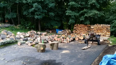

They did a great job. Used the stick with a little left over on the end and either spray painted spots holding it up to the wood or just held it up to the wood and notched it. It's all down and cut nicely.
Reactions: JA600L
There's the progress...
