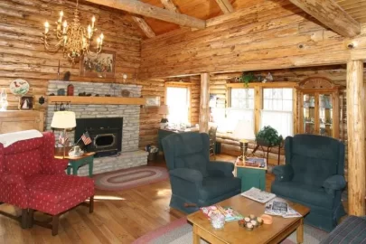

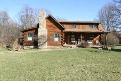

My wife and I purchased a log-home about 2 1/2 months ago. After 21 years of marriage and looking, we found our dream home.
The structure and all mechanicals are 18 years old. It is about 2500 sq. ft (I will attempt to attach some jpgs). It is fairly tight for an 18 year old log home. There is room for improvement in the near future.

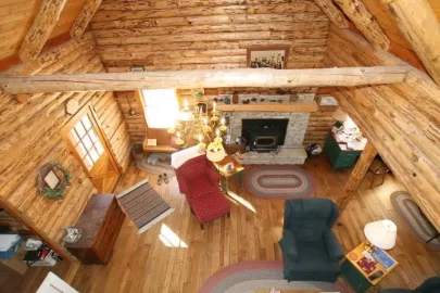

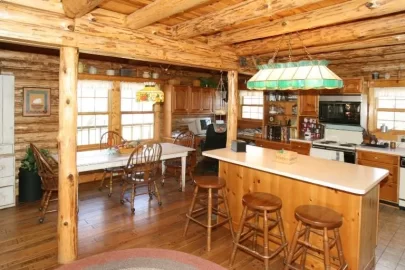

The fireplace, living area, dining area and kitchen are open (960 sq. ft), cathedral ceiling over fireplace/living area. Loft area above is about 400 sq. ft (the girls bedroom). The master bedroom and bath (450 sq. ft 1st floor) and the guest bedroom and bath (450 sq. ft 2nd floor) are down short hallways.

What a beautiful house!! Congratulations!
Nice looking cabin. My dream someday also. If your still intersested in wood, can't you just drop a stainless steel liner down the exsisting chimney and purchase a new insert? The Accentra would look nice also.
