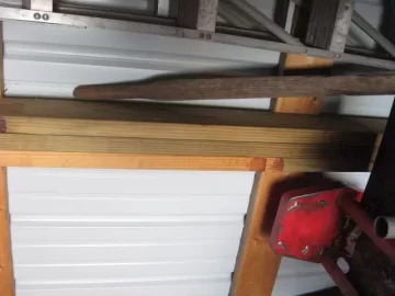

6x6 is over kill for your posts. I've built many decks and never used anything bigger than a treated 4x4. I wouldn't worry about burying them in the ground if you use rock as fill for drainage. Here in my area we have to dig holes to a minimum depth of 48inches for frost. If they are available in your area and you were worried about rot you could go with a laminated treated post like use. Glued and nailed together after the treatment process so more chemical is infused into the wood.
[Hearth.com] deck foundation OOPS sideways but you get the idea.
Thanks guys. I already have the 6x6 (the posts are so short that one 8ft-er is enough), and that was what was in the approved plan (I'm sure you're right that 4x4 would pass, but it'd be a minor hassle). I like the idea of those shaped pyramidal blocks - I've seen ones that'll hold a 6x6 on the www, but I don't think the local Lowes/H'Depot have any but the 4x4 ones.
You can use the 4x4 pyramid with the 6x6 post, just rabbid out the foot of the 6x6 to 3-1/2"x3-1/2"....it will lock in nicely...
