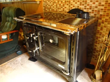

Since there seems to be little in the way of reviews over the Hergóm / HearthStone Deva 100 Range Cooker, let's start up a conversation and see what we can accomplish. Hopefully too, we can flush out a few more owners as I can't be the only one in North America that took the plunge and bought one. If not, then I guess I'll wind up being the guinea pig. One caveat, though, this is my first cookstove and the first winter I'll be using it, so if it's just me answering, it will be a learning experience for me as well and/or it may take me time to give back an impression or experience, but it's a start if nothing else.
So, fire away with questions, observations and thoughts and let's see what happens.

Thanks for posting akbear. I've only seen this stove on a showroom floor. It sure is a good looker. Why not start by giving us a tour of the stove and its features? The cooktop layout is unusual for a cook stove. Is that a convective vent in front of the flue collar? Is there anything unique about the firebox? How do you clean soot accumulation?
I agree, it's beautiful. It caught my eye on the showroom floor as well, so much so I grabbed the brochure and it's still on my coffee table. I'd love to hear about your experience as you go through the winter.

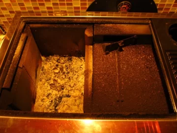

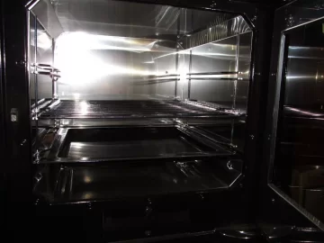

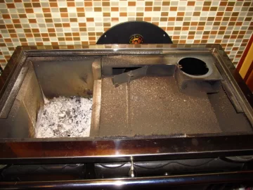

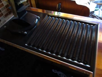

In front of the top flue exit (I moved the collar to the rear exit on mine of course) is what they claim to be a grilling plate, and even though this is enamelled cast iron, I personally could not imagine using it as such and wanting to clean that area off, plus it's most likely the coolest part of the top (though with a top flue exit I suspect it would get somewhat warmer than my configuration as some of the heat of the collar would conduct into it). In any event, I plan to use the "grill" part as a warming area and since I'm likely overly paranoid about thermal shock (I don't even like to put a pyrex casserole into a preheated oven) I'll be preheating cookware there too. (and it's not as though I've never cooked on a ceramic glass top before, but it's one thing putting a pot of cold water on a cold stovetop and turning on the burner than it is doing that with a burner already on full blazing hot).
It is kind of a shame that they are only importing one model, colour and options as otherwise a cast iron top would have been available as well (but if one really wanted to, or wound up perhaps breaking the top, the simple rectangular top should be easily replaced with whatever one would want I should think). That said, perhaps one of the advantages to the ceramic top (besides ease of cleaning) would be for summer use since it would nearly be as responsive as an electric when it came to time of applying heat to being at cooking temp, and being able to then let the fire die out before the cast iron components had a chance to soak up the heat (and not having to resort to removing a hob for direct flame contact).
For cleaning the airways, there of course is a cleanout door below the oven, but the easiest part is that the ceramic glass top in it's own frame lifts off. The grill plate appears as if it would do the same, but unfortunately when I had the top off, I did not try that, so I can't say for sure if it needs to be unbolted first (by either the collar/cover bolts or if there were two under that securing it to the flueway in the stove). I just didn't pay attention as much as I should, but I do know I'll have to remove the top exit cover to access the bypass part of the flueway should it require removing other bolts below instead of lifting off in one piece. This does, though, bring up an oddity. Using the rear exit on this stove still does mean that to some extent that even while using the bypass, the flueway in that configuration still does a short downflow before it can exit (while it certainly shortens the route that goes fully around the oven, the rear exit still is lower than where it exits the firebox).

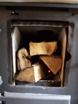

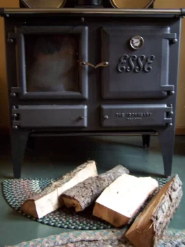

the firebox on this is larger than the esse ironheart, but log length is slightly shorter. (If I recall correctly, the esse is 1.43 cu ft and takes an 19 1/2" log, the deva is 1.65 cu ft, but takes a 17" log). There is about a 3 inch lip from the bottom of the firebox to the lower edge of the loading door opening and firebrick is on the sides, the back appears to be cast iron (though the back of the stove is insulated). The bottom of the firebox is almost hard to explain, there is a cast iron frame that a firebrick insert fits into the centre, but then there is a cast iron insert that fits into the firebrick which also has a cast iron grate insert in the centre of that. So perhaps the downside would be that firebrick would have to be ordered from the dealer for the stove as I'm unsure one could take generic firebrick and whittle or grind the needed shapes without great difficulty. (I did find a decent pictorial of a breakdown/assembly of the stove on the antiquestoves site, just look down the page for the picture of the deva, click on it and it will take you to that page.) Other than that, it seems quite simple, there are only two controls on the stove, the bypass lever on the front, and the air control on the bottom of the ash door (which seems to be an incredibly small air intake compared to other stoves (especially when comparing to something like the flameview)
Here's what easily fits in my Esse... I also have a bypass for the oven heat, a built in pipe damper on the stove outlet, a primary draft at the bottom and a secondary draft at the top of the firebox. You can see the knob in the upper left.. Once my fire is going I completely close my bottom draft and just use the secondary upper draft which creates those nice ghost flames above the fire, thus giving me a super clean burn,, burning off the secondary gases.. Good luck with your new stove.. looks great...

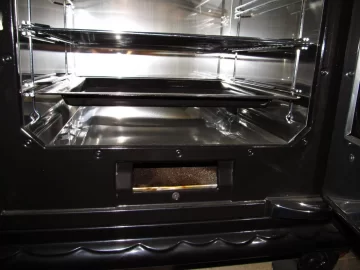

So here again, I can't answer about the oven either yet, at best I have only had a fire big enough or long enough for the oven door thermometer to read 200 or so (I doubt I've yet approached 250). I plan with my future fires to further test with an oven thermometer on the rack in the centre of the oven, so there will be some extra information to come.

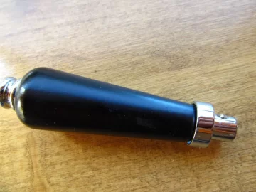

well, you got me to learn something today. After taking a picture of the firebox door handle I then compared it to the ash door handle, which is different as it doesn't have the quick connect fastener on it. So, now we know the firebox handle was designed so one could remove it to keep it cool and just snap it into place when opening the door. So far with the test fires it simply didn't get hot enough to bother doing that.
But, I will say one thing I already learned when I had the stove going, not to grab the handle too close to the pivoting point. In other words, the metal part that the handle snaps into on the door does get hot. [Hearth.com] Deva 100 Cookstove Q & (hopefully) A.  Owners & those considering

I did wind up baking a small test loaf of bread, and I'd have to say it came out well enough that I might even repeat the test to see what happens doing it exactly the same way, but in one of the cast iron pans instead which might be a much more appropriate sized pan for that amount of dough without resorting to using the kitchen aid instead of the mini-zo to make up the dough (more about that and lunacy (well, perhaps a day late for the full moon) that lead up to that point over here https://www.hearth.com/talk/threads/whos-burning.114036/page-2#post-1523759)

I have discussed the issue of canning with Woody and going with his recommendation of having a quarter inch thick stainless steel plate made to replace the glass cook-top.
Should solve the problem.
Have you tried cooking meat on the grilling plate yet?

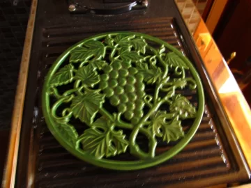

You might even want more than one trivet.
I actually have two that I bought off amazon a while back that should I need one I can just slide the rubber feet off and rotated just right it will fit solidly over the grilling plate.

I have discussed the issue of canning with Woody and going with his recommendation of having a quarter inch thick stainless steel plate made to replace the glass cook-top. Should solve the problem. Have you tried cooking meat on the grilling plate yet?
I really don't think I want to grill anything on the grilling plate (even though it's enamel coated, for me it seems like it would be an extra cleaning job I don't want to take on. Instead I'll be using the area as warming area (and prewarming kettles before putting them on the ceramic top), to simmer things and if the lowest temp of all (for me on the top flue exit cap) isn't low enough, then I'll pull out one of the trivets.
A steel top seems a good solution, especially if one plans canning. I imagine if this stove was available here with the standard cast iron top it would be just as heavy as most every other cookstove. Another thought about a modification, I am going to just see what it would cost to have a metal fabricator make a backsplash and warming oven as this does project a good share of heat that I'd rather be directed away from the wall and ceiling above (Not that I've reached any wall temps of worry as of yet, plus on top of that my walls are canadian envelope to start with, but behind the stove it's modified so that behind the tile and cement board there are copper bell standoffs in the airspace and a class A radiant barrier over the studs, I'm the type that would like to see a greater margin there. And of course beyond just the tests and getting a feel for the stove, it's most likely that I'll be looking for the best combination for running the stove slowly as when it comes to heat I probably could have gotten away with buying a sardine stove (http://www.marinestove.com/sardineinfo.htm) but I have yet to come across a woodfired easy bake oven (I'd just have to make very tiny casseroles and baked goods that I'd have to fight the dog over)

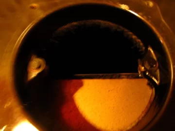

Well, I no longer feel slighted that I missed out on getting an Esse. Last night I had nothing better to do, so I went about seeing how much was involved in giving the Deva a cleaning. Of course we already knew that the top just lifts off (and it's easily done by one person, just push up from underneath with one hand, grab the front edge with the other and then with both hands lift it away)
As I suspected, the grill plate is held down by two bolt sets which only have to be loosened and slid off the prongs (I have since left them off as I'm using the rear exit and while not being transported the cast iron grill plate would hardly have the mind to simply float away, and as for me, do I want to remove 6 bolts or none for a cleaning? (4 bolts holding the top exit cover down and two bolt sets securing the grill plate) Obviously I refastened the bolts holding the top exit coverplate when I put it back together.
Then the grill plate simply lifts off giving full access to the downdraught flueway on the far side of the oven and other areas which need attention (and of course lastly would be to rake the ashes from the bottom through the hatch under the oven)

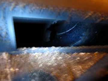

Compared to other cookstoves I have seen, there really aren't any places that are overly difficult to access, and no baffles or gussets to serve as problem areas, though I came to the conclusion that a long bottle brush and/or an ash vacuum will be much more effective than using the scraper tool, and none that are totally inaccessible from one access point or another. Also I'd like to add some clarification about what I had said about still having some downflow when using the bypass and the rear exit. It's somewhat visible in the picture above, but here is a closeup through the bypass door prior to cleaning
The top of the rear exit is somewhat lower than the bypass doorway, but nowhere near as restrictive or complicated as I had imagined from looking at assembly pictures of this model.
