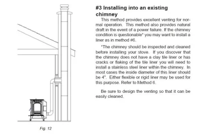

I think a closer look at the install manual may be a good idea as well. It will tell you what size pipe is needed and probably some other installation requirements
I have my Harman XXV into a chimney that I had used previously for a wood stove. It has an 8" clay flue liner which is relatively new. The install/operation manual for the XXV mentioned this as one of the methods to vent the stove. Dealer backed this up as well. I don't know if this would be a recommended way to vent for all stoves, but this has worked well for my XXV for three years.

That type of install is also permitted for Quad's, including the CB1200, if the chimney is in good condition.
