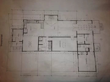

Yes, here is the floor plan. It's a bit hard to see--I took the pic from my phone, but the stove location is the little bumpout at the "top" of the photo which is the south side of the house. The monitor heater is going in the spare bedroom in the lower right section (NW), and the west room that leads off to the deck is a solarium that is a heating source unto itself on sunny days. We have all new insulation above, below, and in the walls; new doors and new windows, so I've hopefully banished all the leaks.
[Hearth.com] Did I Make Complete Blunder Buying This Stove?
We've got a maritime climate here--no snow and few freezes. I'm looking up those Napoleons and Regencies as per firefighterjake's suggestion.

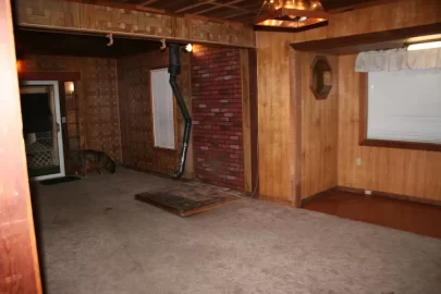

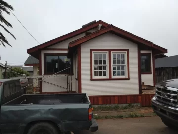

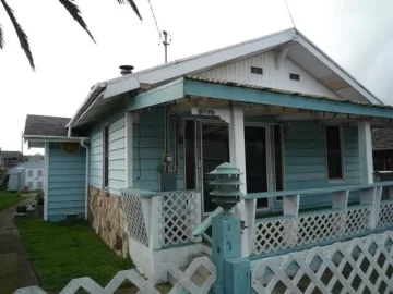

Here is a pic of the alcove (before gutted) and the before and after of the house exterior, just to give an idea.
What an adventurous chimney construct.
