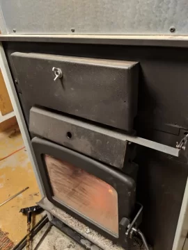

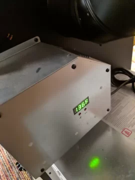

Hi, i have a thundra 2 furnance and i have difficulty to keep the second burning working more then 5 or 10 minutes. as soon as i turn the ''key'' to low (around 145-150F on the fournace meter) everything start well but then like i said 5 or 10 mins laters it had loose all its warm the 2nd burning stop. anything i do wrong or is it normal ? its my 2nd winter with it and it been alway like that !

What is the 'furnace meter'? Can you post pic of it? And 'key'?
Or, maybe someone with a T2 will be along and know exactly what you mean. But it's fuzzy to me.
Just read the furnace manual for the heatpro model, same thing but the next bigger model, and Drolet talks a lot about how to start this furnace and expect secondary combustion for about 50% of the burn cycle. They say that wet wood or insufficient warm up time is the usual cause unless your draft is out of spec.
Second thing about tube type units is if you turn it too low too fast you lose your off gassing due to insufficient charring of the fuel. You need a good coal bed and just enough air to see just a bit of active flame above the coals ( best description I can give).
for the chimney its a 6'' diameter and 27' long my wood as ben cut and split about 5 or more year ago store in a shed all time, so if i understand i should do a ''pre brun'' with small stuff tu get an hot coal bed and then do the real one with a lot a log and get it going ? the 2 picture are the ''key'' and the meter

Pretty sure that digital readout is just your duct delivery temperature from the probe in the duct. Used to cycle the blower.
That’s not your flue or stove temperature.
That's true...
