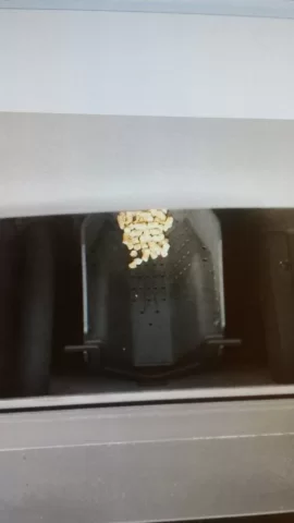

I know there is a different fan cover and larger hole burn pot. I just have not seen any specific direction for a conversion. What are all of you doing?
I use the large hole pellet burnpot with 2-00-724-105 burnpot retainer, no stir rod or burnpot hood, large hole exhaust cover or modify corn cover hole size, and feed position at 3 or 4.
You may have to adjust dip switch positions 1, 2, and 3 depending on where they are now. These switches determine how many seconds the auger feeds pellets during start up.
Mine burns pellets wonderfully. Very low maintenance stove.
Thanks for the replies I dont have much experience on the burnpot set up on these
[Hearth.com] Directions for optimizing a pc45 for pellets Inside view of my burnpot setup.
