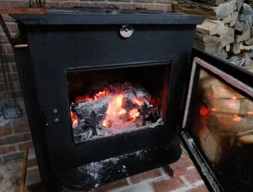

Here's my other stove on a fresh reload after a 24 hour slow burn. Previous load was 80/20 oak cedar, this load is all oak and ash.
[Hearth.com] "Dirty" Blaze King windows
In both cases, you will note that only the lower corners of the glass are dirty, the rest is clean and clear.
Is this really dirtier than others? My Jotuls were usually dirtier than this, and they could not burn anywhere near as low and slow as these stoves.
I contend that anyone complaining about dirty glass on a BK is either always burning much, much, much lower than any other stove can, or their wood isn't quite as dry as they believe.
