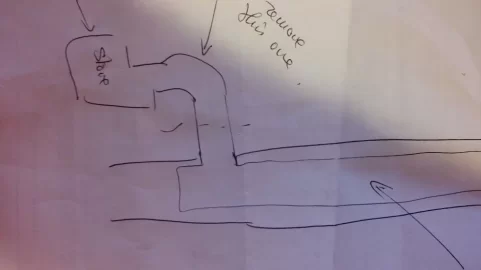

The 90 degree angle is were the stove pipe connect with the liner in the chimney I attached a diagram so you can understand my setup.

Not seeing image. If you can remove the elbow that's your best bet to using the sooteater. It will bend some but not 90 degrees
I know it is a 90 degree angle so the sooteater will no work
I cannot remove the second elbow as it is in the chimney and they are bricks around it
there are not options that I know of that will make those 90 bends so you can clean it in one pass. A chimney sweep would removing some pipe and do a top down and then clean the pipes from the stove and vacuum out the bottom of the chimney. I would get a a sooteater or 2 (I got 2 so I could have enough rods to get all of mine from bottom up). If you pull the pipe going into the wall you should be able to run the sooteater up, keeping the drill low will reduce the angle. When I clean my inset I basically have a 90 deg bend from the door to the liner and I haven't had any issues yet.
I work my SootEater through a similar setup to Damien's... solution was to push the rods all the way up to the cap without even hooking them up to the drill, then hook up the drill and back them out while spinning, and disconnect each rod as it comes out. Tedious, but it removes the excess pressure of forcing it through the 90 by making the angle less acute.
Mine is very similar to Damien's diagram, except the stove is configured so that the pipe comes directly off the rear of the stove and feeds horizontally, straight to the elbow through where the old fireplace used to be. It is an interior chimney but I have access because the original brick chimney was crumbling after more than 100 years and the bricks were literally turning to dust, so I removed the whole thing brick at a time, and the metal flue was erected in the empty chase. I can access the cut-out at the bottom of the elbow, so that's where I insert the soot-eater. Because the elbow is low to the floor, I can just barely get by with about 75 degrees of bend with the soot-eater, and I still managed to break one rod. After 2 seasons I had a chimney sweep clean and inspect the chimney. He climbed onto the slippery metal roof and went from top down and didn't even bother with the cut-out. He swept the chimney with a brush while an assistant ran the vacuum cleaner hose through the stove damper and pipe to clean out the soot as it accumulated in the elbow.
Damien, have you considered removing some of the bricks from the chimney just under the elbow, enough to gain access to the cut-out? If the chimney is exterior, a removable cement plug could be fabricated to close up the hole. I'm assuming the liner now functions as the chimney and that the bricks simply remain in place because you didn't want to remove them, merely providing support for the metal flue. My metal flue is surrounded by the house framing, observing all recommended clearances, and the wood gets only comfortably warm to the touch with a hot burn, so I would see no problem with just leaving the hole open if it is an interior chimney.

Yes I have but it would affect the integrety of the chimney
Donk sounds like he has it figured out. makes good sense to push it up one piece at a time then start pulling keeping less stress on the connections.
