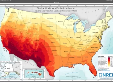

What you're seeing there is also a reflection of local grants, rebates, and feed in tariffs promoting solar electricity.
According to this map I receive very similar amounts of solar energy as you do, and my house is net-zero for electricity with my system.

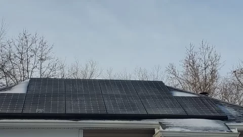

I live right on the border of the 2 lightest yellow and put in solar panels Feb of 2019. Projected break even point of solar is about 10 years out assuming 3% rate increases. After that I'll be money ahead. Lifetime of system savings is about 40k.
I'm looking at a 5 to 7 year break even point.
Yeah, your probably at least 3 solar zones better than me. It's all good though... I don't plan on moving, don't want to deal with my years of hoarding. Kids can when I get carried out!

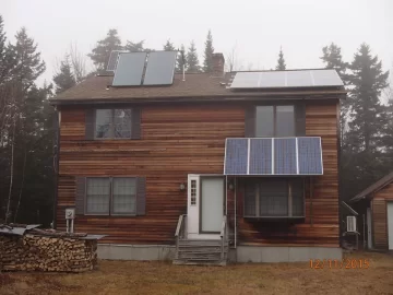

So here is my roof mount and my wall mount. The wall mount is 660 watts, (its my original system about 20 years old) the roof mount is around 2100 watts. The two panels that sit up off the roof on the left are solar hot water panels with a DC solar panel that runs the circulator pump. I tipped it up from roof angle after a few seasons of operation as tipping it up give me more heat in the spring and fall and less in the summer. The roof panels are fixed and get covered with snow for days if not weeks in winter. The wall mounts are adjustable angle. It requires a hydralic floor jack and wooden beam to move it. Takes me about 15 minutes.
My 12K minisplit is on the right. I run it on surplus net metered solar. I went into the winter with 2500 KW to play with.

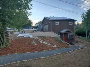

This was before the concrete path and the gardens, but it was one of the only pictures you can actually see the panels. Our main house has 2 7 panels, but they are pretty much blocked by a tree.
