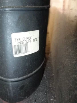

We need to upgrade the black stove pipe on an old cook stove in our cabin and we need an odd piece of pipe.
Anyone know if any company manufactures a 7" oval to 6" round transition piece?
The stove currently has single wall pipe.
