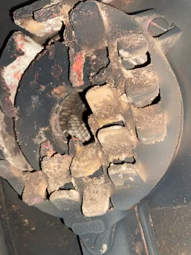

There is a previous post on this stove and I have a similar problem. I don’t know the name of the part but it’s the round cover that goes over the catalytic honey cone piece. I guess it’s supposed to use the smoke as fuel for more heat. Anyway this part seems to be unobtainable so here is my question. Is ok to use the stove and just leave the main damper open and never use the catalytic system. I realize that the wood will burn up much faster but the stove will still provide heat. I’m going to have the chimney swept next Tuesday and hope maybe they will have some answers. I don’t really want to replace the st
  • [Hearth.com] Dovre heirloom
That's the turbulator,or inner top baffle. Getting a replacement could be hard. However, a similar part was used in the large Consolidated Dutchwest stove and it is still available. It would take some grinding and modifications to fit.
Here's a trip down memory lane about the same issue.
Thanks for the response’s. I have thrown in the towel and decided to replace the stove. Couldn’t get the old one off without drilling and grinding. I will be replacing this with a Hearthstone Green mountain 60.
