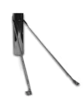

Could you use a Telescoping Roof Support then add a second 4' section of pipe getting you 12' of chimney, still on the short side but better than 8'. Then if needed, you may be able to add another section of pipe, like a 2'. You'll have a better sense of how well it drafts once the colder temps arrive, but you could experiment with a inexpensive galvanized pipe at different lengths, to see what height you need, to get the best draft.

The problem with putting some now and adding later is that I don't trust myself to do it correctly so we're hiring a sweep to install it, so I don't want to have to pay them twice if it can be avoided. Is 12' long enough or do I need longer? I might be able to use that bracket thing to get a taller one. What is a good minimum height, or what do people usually do with one-story installations???

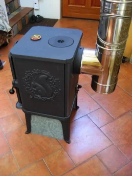

That's good advice, double-d. Whatever length of flue you choose, I'd also recommend a T fitting for easy cleaning.

I really like the idea of the T-fitting for easy cleaning...and the venting from the back (as I want to heat water etc. on top), do you find it reduces the draw though? But then I believe your chimney pipe is much taller than mine would be?
There's a cap under the T so you can take it off and run a cleaning brush up the flue from the bottom. Out the back is great in that it keeps the top of the stove clear. I don't know if out the back reduces draw because in 42 years of owning stoves I never vented one out the top. Our flue is 24 feet long so draw is no problem. We put the whole thing inside the house in order to reclaim the maximum amount of heat from the flue. From that black ceiling box out the roof the flue is double walled.
A 6 inch flue on a really tiny stove with only a .7 cubic foot firebox is ~way~ oversized. So Morso designed a cast iron cup shaped "one way" restrictor that partially obstructs the potential of any backdraft flow while allowing a smooth unobstructed flow out the stove. As an experiment I burned the stove without it to observe the effect. Stove temps were significantly limited while flue temps shot up.
Is there any disadvantage to the T-fitting? It seems a great option and I wonder why I don't see them on here more often, just wondering!!!
No disadvantages that I know of other than being more bulky looking. I saw one on another stove and thought it was a really neato idea. ;)
With a short chimney i would get a top vent stove and go straight off thr top and out. Most stoves are to pull baffles ect to clean from the bottom. And honestly i find it easier to control dust that way than with a tee.
Yes it is a 90 that reduces draft. Now if you have a rear vent stove absolutly put a tee behind it. But most new stoves are top vent and most top vents beath easier

Are you sure Morso requires a 6" flue? I would install the smallest one that meets all approvals. I would also use tripod roof supports to extend the flue so it is at least 12' if not more.

Consider the BK Princess with a 2.8 cu ft firebox. That's four times larger than a Squirrel firebox, and yet it uses the same size 6 inch flue. The Squirrel comes from the factory with a 6 inch collar, but from operating it I believe it would work just fine with a reducer, a 4 inch flue, and with the internal restrictor removed.
