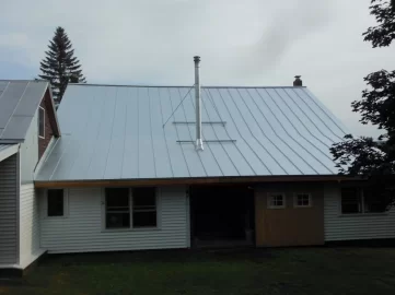

Interesting, I'm glad you mentioned that, I did not look into the UK manual at all...sounds like I should shoot for 13-16 feet. I'm just concerned about having 7-10 feet of chimney above the roof...is that normal??!
Chimney height vary depending on the installation and location relative to the center of the roof and pitch of the roof. We have 7' sticking out because our chimney doesn't exit close to the peak. It looks fine and has a single brace. Picture attached of a simple install as an example (not our chimney).
Is the stove location set in stone or could it be moved closer to the center of the house? That would reduce the exterior height a bit.

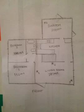

The location is not set in stone yet, that's what we're really trying to cement now (if we want to get it installed before snow flies we have to decide pretty quickly). The problem is if we put it in the main house the cost of installation and mostly the cost of a chase to cover the pipe (that would come out either the front of the roof or the front/side of the house) is getting insane. I finally got a quote yesterday and when you add everything up it's getting around $15,000. Out of the question in my mind. If we put it on the back finished porch the cost is closer to $3,000.
Below is a pic I'd posted in January when we were STILL talking about location :). the new idea is #4. I know it will NOT help heat the main house (huge bummer, it really is) but that room is very chilly in the winter (slab floor and planked/rubber roof) and at least hopefully it will take the chill off back there and let us use that room in the winter...assuming of course it's not too big to burn of out of that one room!
  • [Hearth.com] Draft install concerns
Also question, in the above layout *3 has a huge intake vent right there...am I correct that that would have to be significantly moved?
Do those braces work on a mostly flat rubber roof too?
Yes, #2 looks great, but that installation price is ridiculous. There absolutely is not $12,000 more work or materials there. Not even close.
The stove is supposed to be at least 10ft away from the return air intake. That location looks like it also might mean a very tall chimney pipe outside if there is no room above it.
That estimate (which is my estimated adding of the cost of stove, pipe, installation quote and contractor chase quote) was for location #3 (though more where the window is, we were thinking of moving the window). The chase quote was very expensive but it was to go up the side of the house. I never have received a quote on doing a chase for a pipe just coming out of the roof, though one contractor briefly surmised it would be $1,000...which I find very unlikely, isn't a chimney cover piece almost that by itself?!
the same stove at #2 would be more like 3500-4000 I think BEFORE whatever a contractor would charge for the chase and cover. So I'm guessing 6000 at the very least.
The problem is any installation in the "living room" will require a chase as it will be on the front/side of the house. I live in a city and have to be aware of how things will look on the front ;).
Yeah that would require a huge hvac change. above the "square" of the main house is a 1/2 story cape cod style upstairs. The sunroom on the back is a one story "addition" type room on a slab.
