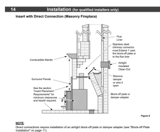

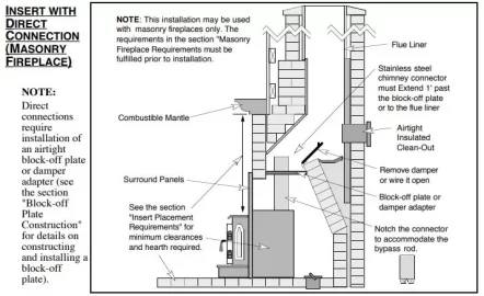

Not a slammer install I don't think. Here's a pic the install I'm referring to as an alternative to full liner.[Hearth.com] Draft sufficiency block-off plate vs full chimney liner

Not a slammer install I don't think. Here's a pic the install I'm referring to as an alternative to full liner.View attachment 236136
Are those instructions for your stove specifically? Regardless I would never install a stove that way. The flue gasses will leave the pipe and expand rapidly causing the to cool and fo creosote. Which will then require pulling the stove and blockoff plate to clean

That is an adsolutly horrible way to install a stove. Is this a ul listed stove? Because if so I am surprised that made it through the approval process.

It's a legal option, but far from desirable. In the OPs case, with a shorter chimney it could lead to poor stove performance due to insufficient draft.

A real direct connect is bad enough but that is just horrible.
