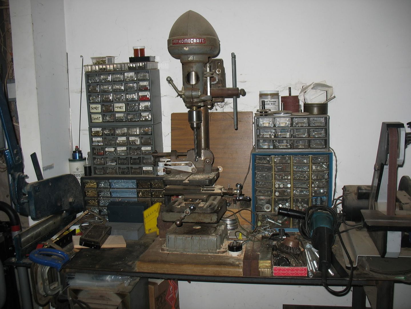

Here's a pic of my old Delta homeowner's drill press. It's a beefy little pig of a tool that has served me well for about 15 years or so. The compound slide table and vise that came with it are sitting up on the table. $50 for everything. Worth a gamble even for a newbie at that price.
Flanking it to the left is a next-to-useless 12" shear made in India. Supposed to cut 1/4" plate, it has trouble with 16 ga. They didn't get the cutters aligned right, so heavier metal just causes them to separate too far to cut. Suppose I can sell that for a profit now as well, only cost me $125. To the right is a made-in-China 5" Makita angle grinder that has held up to some serious grinding, so some stuff they got right. Chalk it up to Makita quality control. Farther over is a Delta 42" belt/9" disc sander that... well... it's getting sold too. My 72" Bader belt grinder would consume that entire sander in about a minute.
Sorry for the huge pic, I forgot to downsize it before uploading to my Photobucket account and I'm too lazy to redo it.

I have the same one. It's hard to go wrong when you find a tool like that at that price.
Or 5X the price if you have to. Luckily, they are to be had for much less, so you don't have to.
Now find me an 8" industrial bench grinder for that much and I'll be happier than a pig in poo. :cheese:
