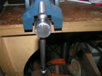

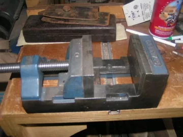

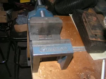

    Currently own 1980 Craftsman 8speed floor model (first major tool I bought,saved paper route /lawn mowing money in highschool.) Spindle bearings about shot now,cant find parts for it.Its the model just before they introduced rack & pinion table,you have to raise it manually,no fun there. Also own 1991 Delta 5 speed bench model,originally set up for sole use with Morticing Attachment,dont use it much now.Both are decent,not as good as 1940-60's stuff,but loads better than comparable stuff sold at Lowes,Northern Tool,Home Cheapo etc today.Am watching for a decent 1940's or later Atlas or Delta/Milwaukee or Rockwell model thats not too pricey.
    My Stanley No.994A Vise. 4"wide jaws,4 1/4" opening,16pounds.Late 50's-early 60's paint scheme,from retired machinists estate sale.Design of these vises was carried over from North Bros. "Yankee" line,when Stanley purchased their Philadelphia company in 1946.Production of their vises,braces,the famous "Yankee" spiral ratchet screwdrivers & push drills was moved to Stanley's New Britain CT factory in 1953,soon afterwards the quality started to gradually decline.
