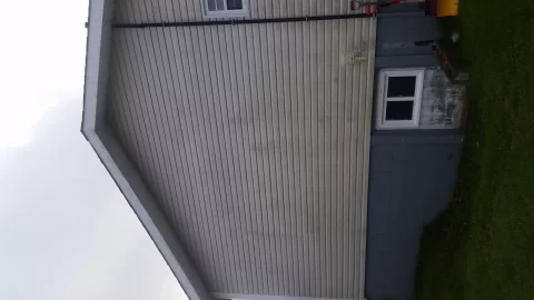

My chimney will be running up about 3 feet to the left of the peak in the roof...factory made 2 inch think insulated pre fab chimney....
  • [Hearth.com] drolet tundra install
