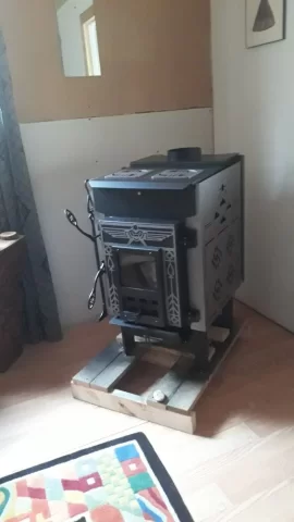

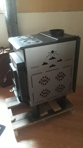

Hey Be Green---I just want to thank you for recommending the Survival Hybrid by Woodstock Soapstone last year---after much deliberation, I bought one and got it delivered recently and am having it installed next week---here's a photo. I am happy with the look of it and am excited to use it this winter.

Great! Keep us posted on how it works out for you.
