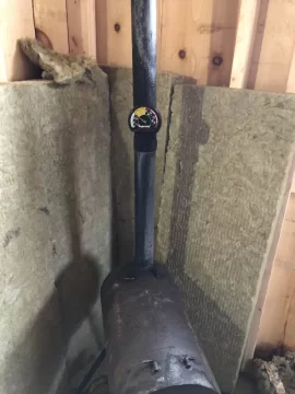

He should be looking down more at that wood pile with a stove on/in it, rather than all the time looking up at his pipe. o_O

The wood is at the bottom drying out for me while I have a fire going. I took a pic of the stove to let you know what kind it is pellet or gas. I’m going to take a pic of the pipe tomorrow and post it. It hold great temp and my wall is nice and cool.

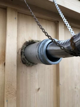

Everybody makes fun of my safety features but in reality behind all the insulation and my triple wall pipe going through the wall my shed walls are pretty much cold to the touch. I know it’s not to code but for a fire for just a hour or two it’s perfect.

If it is either of them (which is the only 3" that would be at a hardware store) it is not made to contain exhaust from a wood stove. Pellet vent might hold up but not offer proper protection. B vent could melt. Pipe is not pipe. You clearly spent quite a bit on the solar setup in this shed but refuse to spend much of anything to keep from burning it down. And Batts of insulation leaned up against the wall is not proper protection.

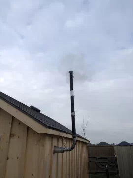

[Hearth.com] Duct work for double walled pipe? [Hearth.com] Duct work for double walled pipe? [Hearth.com] Duct work for double walled pipe?
Triple walled insulated with Rockwool!!! Common.
No it is not common. And insulated chimney pipe still needs 2" clearance to combustibles.
Better than what it was anyway.
You mentioned black smoke. What are you burning in the stove? Shouldn't normally see any black smoke coming out of the chimney.
Is this pipe good? I’m not getting black smoke maybe the auto correct changed it I meant to type back smoke. It was smoking back into the shed a little. I just raised the pipe and it’s better. I need that rope that goes around the door for a seal and I think it’ll be ok.
It stopped smoking while it’s burning but still smokes when I open the door
It’s smoking soo nice outside now No disruptions.

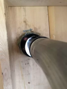

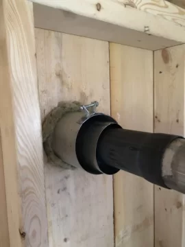

Creosote draining back and to the outside?
  • [Hearth.com] Duct work for double walled pipe?
Is that what that is? How do I get rid of that? I was wondering why that was there. I’m burning wet wood with some dry. Is that black stuff bad?
How do you get rid of it? A proper chimney and dry wood. Yes it is bad that stuff will cause a chimney fire which your setup won't be able to handle. It may keep things cool when the pipe is 4 or 5 hundred degrees. But 2000 degrees is a totally different ball game

The fire temp should be around 400-500 I usually keep it around 600 I’ll start closing vents when it get higher. I’ll start only burning dry wood as long as I have it.
Where are you measuring temps
