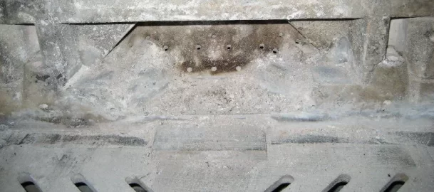

mine look bigger and ported like inside maybe its me 1 st year hopeing for the best
Can you show us a pic?
I have the large model, so that might explain the difference, but mine actually has two size bore holes, the largest size is 3/16th inch. And overall the design looks quite a bit different than the previous picture here. Mine does not have any of those upward facing holes at all.
yeah, your everburn thing looks a bit different than mine... although it could be due to the stove size difference?
perhaps i got the "improved" neverburn
my holes are all 1/4 inch in dia. which if your largest is only 3/16 then overall the 1/4 holes should pull more air?

My setup looks like tradergordos (thanks for saving me the effort of posting!). Definitely missing the two large bore holes on mine.
are you refering to my pic of the everburner....and i assume by saying "2 large bore holes" that some of yours are smaller than the other..
if so then it seems that the newer design has all the same size holes at 1/4 inch
I believe my holes are smaller as I purchased mine early in their production. Fall 2005. I may consider drilling them out a tad if I keep the stove.

well, it would appear i have a "refined" model everburner....
Mine doesnt have those two large holes whatsoever, those appear to be completely new to the design vs. a re-design or widening of the holes in the older designs like mine.

O.K., I just have to ask because I'm curious. Does the everburn thing we see in the photos with the old and new hole pattern/size provide air into the firebox for burning there or does it draw gasses from the back/bottom of the firebox for combustion elsewhere? If so, I presume that the combustion chamber is centered above the firebox and below the removable stove top like on the older DW cat stoves? Is there still a seperate threaded adjustable air supply for the combustion chamber on the left side of the stove (adjacent to the bypass damper leaver)?
not sure how exactly the everburn system works.... i would assume the holes draw gasses to be burned in the piece thats in the rear/bottom..... the secondary combustion chamber seems to be in the rear/bottom, coming up the rear to the chimney... the top of the firebox has the bypass damper only
the adj. air supply lever is on the bottom left.... below the bypass damper

Besides the two big holes you were talking about - it looks like there are also 5 more just like them, pointed up just above the two. I'm still not convinced this is the new design though, if you look at the service manual (which I got more than 2 years ago) the shoe piece pictured in there looks just like that pic posted in this thread - I think its just the difference between the medium and the large models. Its also interesting that the replacement part costs $107 for the large model, and $127 for the medium model. At any rate, it turns out that part is extremely easy to replace (nothing to unbolt or unscrew, just pull the andirons out, pull the metal grate on the bottom of the firebox up and out, and then you can remove the shoe piece. So I think if there really is a new & improved shoe, we should be able to easily upgrade. One of us has to get over to a dealer that has recent inventory and see for ourselves...

Hmmm, I just discovered something else that is interesting - in the new owners manual dated AUGUST 2008, they added one extra part - a side door refractory cover! This was badly needed, and protects the refractory piece when you accidentally close the door on a piece of wood. It would also serve to hold the refractory piece together in the case where it does crack. You can see the new part (#48) in the diagram at the end of the manual here:
(broken link removed to http://www.vermontcastings.com/catalog/elements/files/2008/30002291_Dutchwest_NC_Lg.pdf)
However I don't see any clues in the new manual regarding refinements to the shoe piece. My guess is that if you don't have the refractory cover, you don't have the new and improved design. And since the manual is dated August 2008, I'd also guess that not too many stores have the new design yet either.
