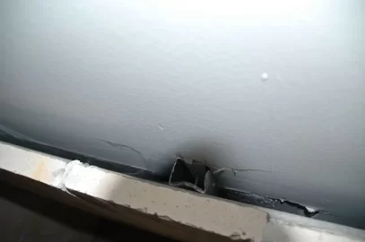

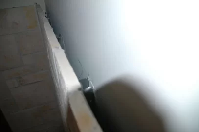

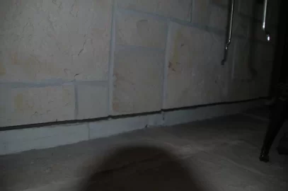

Here is what I had to do in order to pass the building code & ins. req.
  • [Hearth.com] Dutchwest Cast non-cat stoves..... Please shed some light...
