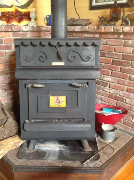

We purchased a used Earth Stove with Warmer Oven and need info on them (model #, how to get manual, operation of. I'm including a picture.
Any help appreciated, we really like this wood stove.

Can't help you with the specific info, but can help if there is a reason you need it. Insurance company needs the info?
This stove would fall under the requirements of NFPA 211 for installation. Most likely, pretty big clearances.
Any chance there is a UL tag on the stove somewhere?

Is that your install?

My thought was a pic from where he purchased, or one found online. Put the reading glasses on and it appears that the yellow wall is brick too. Curious to hear from the op.

I thought that was a possibility to. Which is why i asked if it was their install.
Just looking for information on the stove. My insurance is okay with the install. I just changed out a stove with a smaller firebox. Was having to load it to often and having to split my wood small and cut it short.
Ok but is that a picture of how it is installed in your house?
Yes it is. We bought the stove from a third party who had no information on it.
Ok well in that case you need way more floor protection. Your stove is unlisted so it needs a hearth that extends 18" on all sides. And what is the wall above the red brick made of? I see it resembles painted brick but is it paneling?
