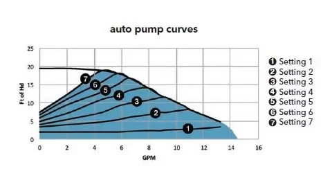

Hi. I put a B&G Ecocirc Vario manually adjustable pump on each of two zones (oil, no pellet boiler yet). After I put in a 120 gal buffer tank, pellet boiler, I'll need a pump for each boiler and was thinking about using the auto version of the pump, which is kind of a mix, as far as I can tell of manually adjustable and pressure proportional, so that it reacts to change in pressure. Say, if the boiler is on, two circs on then one or both shut off and boiler is still on to feed buffer tank. I figure the pump can be set to satisfy both circ pumps when on and some left over for the buffer tank, and when the zones shut off, the pump can slow down and feed the buffer tank at the same (slow?) pace. The boiler can modulate, so I guess key would be that it doesn't shut down prior to loading the buffer tank. Is slow load necessarily that desireable (stratification)? Or, as long as the buffer tank is requesting heat, get it topped off asap. I think I'm talking myself out of the auto pump and into the manually adjustable Vario. (NO RESET, etc).
