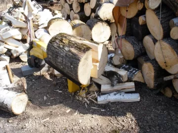

[Hearth.com] Electric Splitters ....Might be a better Choice Right Now ... I used a 5 ton electric for a few years and it split pretty good. They are more temperamental than a big gas splitter. They don't like the cold. And you really want to have a dedicated 20 amp plug and a 50' or less 12 gauge extension cord for it. The start up of the motor takes a lot of power and it will split better with more power also. I bought my generic Chinese made splitter for a little over $200 at a Menards store on clearance and sold it for $125 on Craig's list a few years later. I kept it outside and I covered it when not in use. It worked good until I got into big Maple and oak stuff... Also, I kept a 3 lb hammer handy to help with the stubborn splits. You will also have to turn the rounds if they don't split at first. It gets old if your into hard stuff...

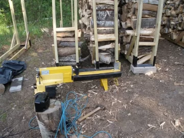

I used to split some pretty big rounds with my electric. If it was Poplar that is. I didn't work on my knees, I sat upon a round of wood by the splitter. I split all of the wood in the picture with the electric and more that you can't see.[Hearth.com] Electric Splitters ....Might be a better Choice Right Now ...
