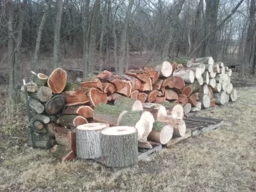

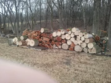

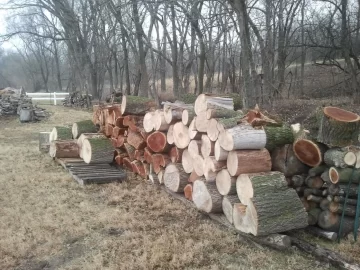

I was driving by the a farmers homestead Saturday, and had to stop when he and another guy were butchering up an elm tree alongside the house. I found out that neither one wanted the trunk, or any wood larger than five inches in diameter. I ran home, hooked up a trailer, grabbed a saw and one of my sons to help me load, and withn an hour added these rounds to the pile. They're the light-colored rounds below. The farmer let me know he was taking out twelve more big elm trees, 20-28 inch trunks, along a fenceline (I can drive right up to them on the access road), and I could have everything on those bigger than 5in dia. I like how elm burns, but man is it a bugger to get split. I was wondering how many other folks here split and burn elm, and if you all know any tricks of the trade to make elm easier to split, I am all ears.

Never split that kind of elm and never split it green either. I would be guessing if I said let them rounds sit awhile and it will be easier. No need to wait if you have a splitter because it will do the job.
I've only had a small red elm and it split nicely. You sure the light stuff is elm? kind of looks like ash. But like I said I've not seen any American elm.
Unfortunately I do not think there are any tricks beyond effort to split elm and hopefully you have hydros. I just removed a badly flagging large elm from my property and almost every split needed the hydros to bottom out as well as some manual manipulation to get them apart. A sharp hatchet helps. I guess the only trick I use is to get way ahead(which it looks like you are) and split large because you can let it sit for 2+ years. Elm is a pain to split but I like how it burns and easy access/free wood is always worth the effort IMO

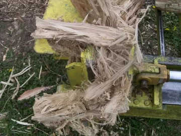

[Hearth.com] Elm Burners?
Jags - love that picture. I cant tell you how many times it just ends up in twisted mess like that! On the other hand those stingy bits catch on fire easy.
Redlegs, we've burned (and split) lots of elm and have done so for years. So far this year we've only cut up 4 or 5 but there are plenty more. They can wait another year with no problem. For sure we do not like cutting live elm. Jags picture shows why we don't like to split it when green. We wait until the bark is off or almost all off. It can even wait another year or two after that if need be. Doing this you can split most of it with a splitting maul, but we have hydraulics now.
Warning: elm that is grown in the open spaces will almost always end up twisted and you'll match Jags split very easily. If the elm is in the woods and out of the prevailing wind, it will grow straighter and therefore split much easier. This means that probably in your area all the elm will be a twisted mess. Hydraulics are the only way to do on those.
Reactions: Redlegs
For the record, that pic is from a tree that was standing barkless and dead for a few years...BUT to Dennis' point it was out in the middle of a field and getting wind battered its whole life. Toughest thing I ever ran across my splitter.
