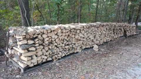

It's about three cords, I figure. Now we just have to wait a year or two for that "money in the bank" to start paying interest. ;)

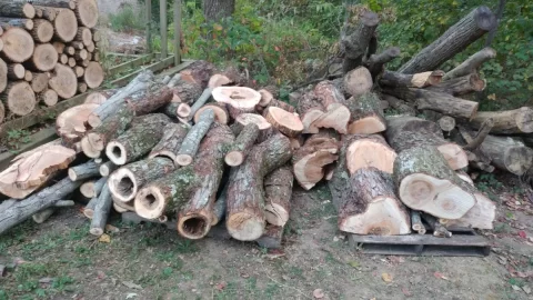

That's good to hear. I have some dead Elm from a tree-man score, bark mostly gone. I'm trying to get my SILs set up for next season, but I'm thinking that the dead-standing White Ash in post #14 above, maybe the windward row might get dry enough, and that's only a cord. In addition to the Elm I also have some Silver Maple that I'm sure will be ready.
The Elm logs are right/rear, more than it looks in the pic, along with a couple Oak and a Cherry. The Maple is in front of that.

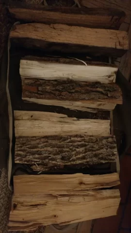

Several weeks ago, I pulled one split from what we stacked in a single-row 2x4-frame rack. It tested 19%. I thought "Well, that's only one split..maybe it's an outlier." So I recently got a few more splits, warmed them up, then re-split and tested. The Sweetgum again tested 19%. ==c

Here's the splits I tested the other day. Top wood is my Red Oak...then their Sweetgum, White Ash and River Birch (no bark pic for that.)
