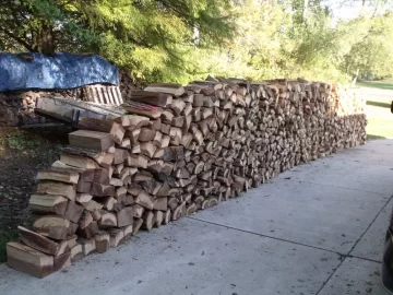

Difficulty of splitting elm depends on the particular variety. little easier to do by hand when frozen. Standing dead the top third will likely be able to use this season if bark has fallen off the lower 2/3 due to wicking action will not be usable until next fall depending on your ambient conditions for drying and that it is split and stacked asap. nothing larger than 4x4. I like Elm just because most avoid it due to the stringy nature of the wood fibers ( really not much worse than some Hickories that I have split, even had a species of Ash that was just as stringy green) . here is 2.5 cord of elm from last Sept. This is split large as I will not need it for about 3 years likely ready in 2

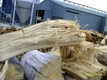

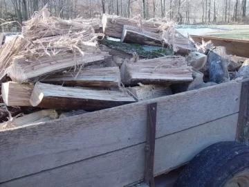

That doesn't look like the American Elm we have around here. I had a load of what I think they called Chinese Elm that looked very similar to that and split nicely like what you've got there dropped off once. But the American elm was nothing like that stuff... I had about 4 rounds that just blew into a big ball of hair when trying to split. They now hold tarps down on my other wood.
Tree service that dropped off logs called it Red Elm- could be a different type, it is not what we call Piss Elm ( Slippery Elm) there was no mucus under the bark. Chinese Elm - Siberian Elm is perhaps what you may be refering to - could be that species.
Slippery elm starts off very wet( when splitting it will on occasion actually squirt sap) yet dries out quickly and becomes fairly light in referance to green weight - I do not think this is that species. A I have that type in my stacks and this is clearly different.
At any rate it is 2.5 cords of BTU's
