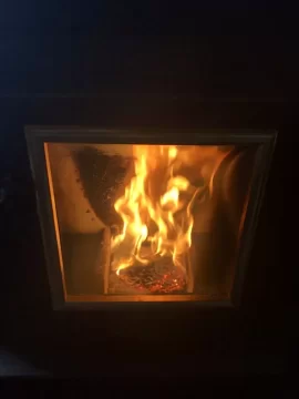

I have a 2005 PDV that won’t respond to changes in the LFF like it did before. I’ve been running a thermostat for two years and this year when the call for heat is removed, it doesn’t revert back to the settings of 1-3-1 that worked for me last year. It seems as though when it reaches set point, and the thermostat cancels the call for heat, it goes back to heat range 1, but it burns like it’s at 9-9-1. I’ve set the heat range at 1, and the LFF at 1, LBA at 9, AOT at 1 and it’s still going through a bag in less than a day. Even removed the t-stat, replaced jumper and tested, same outcome. Reset control board, put it mode D, same thing. Even bought a new control board last year because I thought that was the issue.
From testing with a meter, it looks like the top auger has a run time of just over a second, at a setting of 1 on the LFF...
Picture is after running three hours at 1-9, with bottom three buttons at 1-9-1, and restrictor plate as far closed off as it will go...
Thoughts? Ideas?
Thanks!

Thanks for the info, the thing is the fire should die out with the LFF on 1, heat setting 1. Especially with the LBA on 9. I’ve done the reset, fired it up, same result. I’ve replaced both blowers and augers in the last year, and a new control board this past winter. Even switched to C mode knowing it would feed more, however all that garnered was a slight increase in output at same levels. Which is what I expected...
Shouldn’t I be able to get the fire to die out after start up with the LFF and heat range settings at 1?

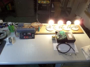

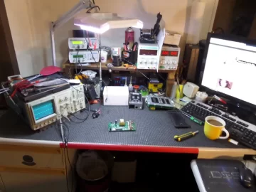

pics of my hangout
[Hearth.com] Englander 25-PDV burns too hot at LFF of 1...
testing a breckwell board
yes there is an englander board, no i have not figured the damn thing out yet ::-)
Seems your all set full cup of coffee and a package of cigarettes
30 years ago that could have been me only it would have been blueprints
but now I don't smoke
busted :p

pics of my hangout
