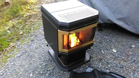

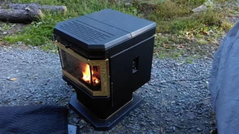

Thanks for the input , picked it up Saturday seems very clean and appears to burn fine so far. Ingnitor doesn't seem to work ,I lit it manually.
  • [Hearth.com] enviro fire ef3 bayi input needed

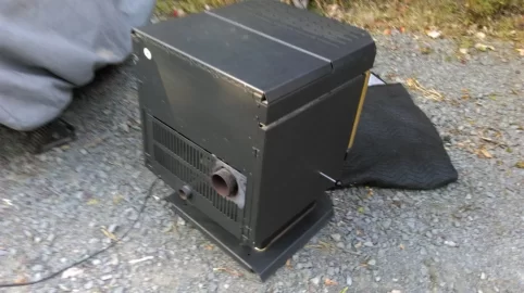

Gonna go through entire stove and check as much as I can , burned outside for well over an hour. It was is super clean, no soot, or ash , a bit dusty that's all.

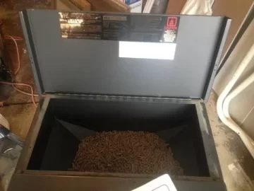

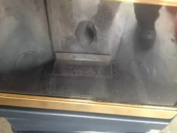

That's kind of what I was looking for a good older stove with more analog controls, can't find much reviews on these, glad you all have had good words to say about them, I enjoy older well made things that are more mechanical and I can work on if needed. Thanks again.

Keep I Clean . Do a complete tare down once
a year for a deep cleaning
If you do that It will give you a warm feeling for a lot of years
Pellet stoves are a physical endeavor ... hauling pellets cleaning routines, and most repairs are fairly simple. Thanks for the pics. Keep us posted on your install. Where are you installing?
Edit: Johneh has a point. While still outside, give it a good clean with compressed air on fans and internal exhaust passages so you can leave the dust outside!

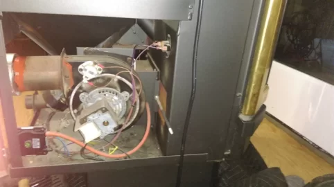

Hi slacker, Enviro makes a pretty good ignitor, I'd measure the ohmage of it (without Power on of course), if good it will read 35-40 ohms. I think there is a timer that supplies power to it but there is also an inline switch that interrupts the power (switch opens) when heated (like when the stove is running). Its in the exhaust path too and sometimes it gets dirty and does not function properly. If the stove is cold, it should be reading closed (0 Ohms). So remember the ignitor could be good, but the switch could be stuck in the open position and not allow power to reach the ignitor.....good luck with her.

So ignitor is shot, any idea where the best place to get a new one is? looks like it was physically damaged by the Previous owner. thanks again for the help. much appreciated.

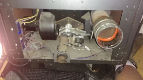

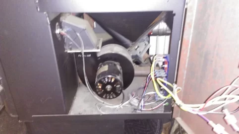

Some inner workings pics.

Any Enviro dealer in your area should stock. (PN 50-1067, retails for about 150.00)
pull that convection blower off and clean it. It's one of last spot most people get to, as it really needs to be removed for a proper cleaning. One of the worst i came across was a customer that complained the stove didn't put out heat like it used to. They thought the blower was bad, i pulled it out and could not see any fins at all. It was full of dog hair and dust and i was able to remove it all intack, looking like a grey furry doughnut
