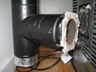

Looks like a plan, don't forget to seal the outside annulus at the thimble (you can get stuff coming in that way and a few people seem to forget that area).

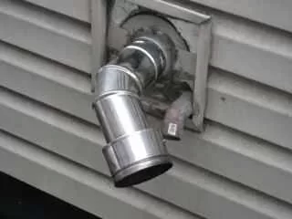

Removed the outside vent and put the cap on (see pic). Easy. I've got 2 questions about the inside vent pipe though:
1. I can properly attach the adapter to the vent pipe, so there is no need to replace the adapter. And, the fastener for the stove is securely HT caulked in there, so that's all good. What looks skanky to me is the way the fastener attaches to the stove. At one time there was a thin piece of white, fibrous material that went in between the two flat pieces of metal that get screwed together. It's mostly gone now as you can see in the picture below. How do I seal where these two plates come together?
2. The 36" vertical vent pipe inside the house is an 24" fixed length pipe and an 18" adjustable pipe. (Although it nets out to 36" vertical, we had to use an adjustable pipe to work with the fittings.) I can't get a good picture of where the pipes overlap. I'm assuming I should load up that overlap with lot's o' caulk and make sure I get the screw holes too.
After this is all over, I'm thinking of making my own line of vent pipe out of heavy duty aluminum foil and high-temperature caulk. ;-)

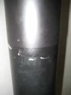

You need to get a lytherm gasket (that white stuff) to attach that joint at the stove.
Also that area that the vent goes through doesn't look all that wonderful either, you should have a thimble there.
To go back to being a member of the code police, you'd get a ticket for that if it were on a house in most places.
I would just use RTV to seal the adapter to the stove. While you have it off, reach inside the vent pipe and smear some RTV on the vent adapter to stove adapter seam.
Also, make sure your smoke isn't come back in through the hole where your pipe passes through the wall.
Yes, seal up the adjustable piece of pipe witha liberal amount of RTV.
At this point, I bet you are ready to pull your hair out. Stick with it, you'll get it eventually.

Liz W. said:
2. The 36" vertical vent pipe inside the house is an 24" fixed length pipe and an 18" adjustable pipe. (Although it nets out to 36" vertical, we had to use an adjustable pipe to work with the fittings.) I can't get a good picture of where the pipes overlap. I'm assuming I should load up that overlap with lot's o' caulk .......
A much easier method to seal the overlap on adjustable pipe is to use furnace tape....available at hardware stores, Home Depot, Lowes, etc. Put one wrap around it, and then paint with black hi-heat spray stove paint.

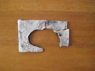

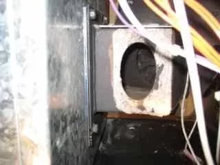

The stove is all cleaned out and ready to go except for two gaskets. I called a local Enviro dealer, and they can't get me the gaskets before next Monday (at the earliest). Anyone know if I can do better online or somewhere else in the San Francisco Bay Area? I'm referring to the mini-backdraft gasket, part # 50-1542 (what's left of mine is pictured below) and the above mentioned Exhaust starter tube gasket, #50-1448.
  • [Hearth.com] Enviro Mini exhausting into house
There is a rubber hose that supplies a vacuum to a safety switch, coming out of the box with the flap you just removed. Carefully remove the hose form the box and clean out the nipple that the hose sticks on to. The stove will not start with out a proper vacuum, and one of the causes is a plugged hole to the the vacuum line.
Also for the white gasket replacement, the manufactures are a rip off. You can order a few sheet of the stuff on line and cut your own for a lot less.
Here is where I got the exhaust starter tube gasket for my mini this year: http://www.fireplaceandstoveparts.com/index.php?main_page=product_info&products_id=925
Hope that helps!
