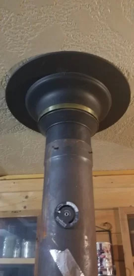

Well I am a idiot and embarrassed but it turns out it is 6". I attached a picture of where it goes into the floor, I always thought that connection was a reducer going from 6" to 8". I always had a outdoor stove growing up. This inside stuff is somewhat new to me

That looks like a 6" to 8" increaser at the ceiling support box.
That's what I thought also but when I look up the pipe it's all the same size and I use a 6" brush also (never looked before now). My father in-law built this house but unfortunately he is no longer alive so I can't ask him what he did but is there a chance since the pipe runs through the middle of the house he has a 8" piped line with 6" for extra protection?
Sure looks like an increaser to me. Take it apart or check the chimney pipe up above by pulling the cap. If it's 6" all the way you are golden.
