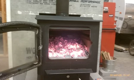

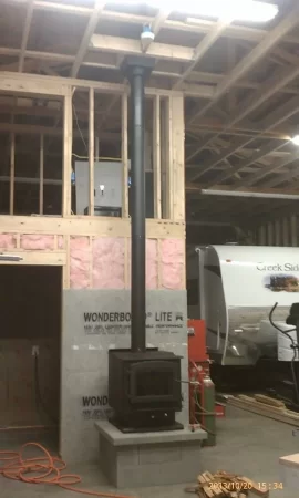

Here's a picture of mine running. The walls are all finished now and insulated, the slab has 2" of foam all around it. The ceiling has plastic but no insulation yet.
