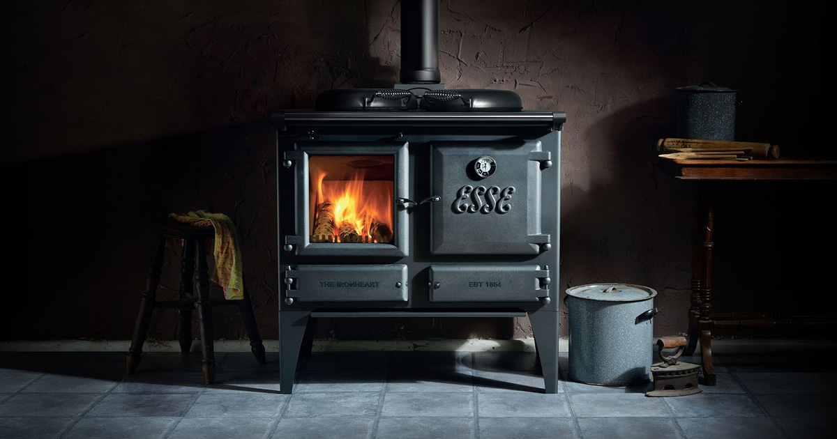

So I have a small office (400 sq ft) on the side of my garage. I don't rely on this space on a daily basis. A little background--I cook with wood throughout the heating season, both in my masonry heater and on my PE summit in my basement--probably equally provided between the two. I'm a bit addicted to cooking over wood heat. When I use the grill or the electric stove, I feel like I'm giving in in some fashion. So, I'm planning on putting a wood stove in the office. I was initially thinking of something like a PE Vista--smallish stove that won't overwhelm the space. Then I came across the Esse Bakeheart and started thinking about putting one in and using it as a summer kitchen. I want to know if anyone has one or has any ideas. Thanks.

It depends on what kind of cooking you want to do. The size is a bit on the small size for me, but for your goals it might be perfect.

I've got the big ticket holiday cooking covered because it falls during the heating season. I know I'm not roasting a turkey in the Esse, but during the summer we tend to have smaller meals. I've really gotten into roasting vegetables, chicken, steak, etc. in the oven. Also, we regularly fry eggs on the wood stove and I miss that in the summer. Using propane and electric in the house/on the grill just doesn't work for me as well. I had a cob oven outside at my old house, and have been kicking around building another one to do the wood fired pizza and bread thing during the summer.

If you think the Esse is large enough, check out the Vermont Bun Baker. It's a rebrand of an Australian stove, but I can't recall the name. There are also some good Eastern European stoves in this size class that are well liked. I got mine through Obadiah's, but they might be the sole US distributor for a lot of the brands. Most of the Amish/North American made cookstoves are just going to be way too big for what you want. Maybe Drolet makes a smaller cookstove now? I think you can get it on Amazon.
