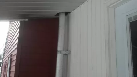

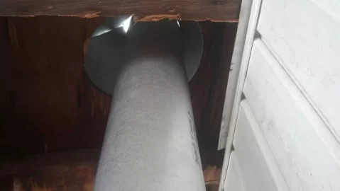

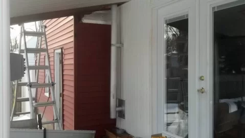

WHEW glad your siding is aluminum............whats under the siding? plywood by any chance?

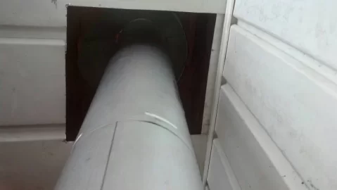

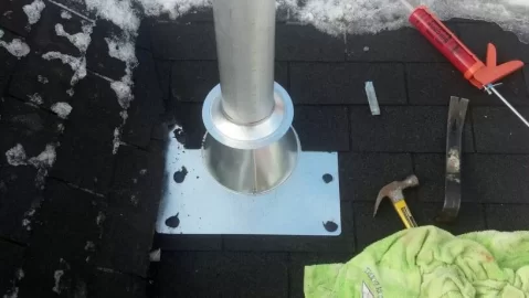

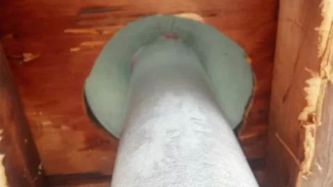

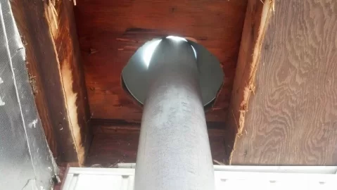

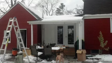

Here's an update. Corrected the vent setup. Please take a look at the videos and let me know if anything looks suspicious.
A few pictures.

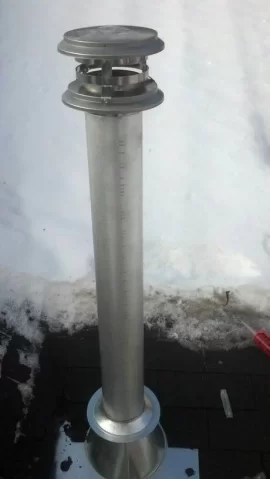

MUCH better. I'd silicone the cone against the flat plate and shingles too.
Have you fired the stove up yet?
I have to buy some of that asphalt in a can crap. Ill apply a small bead around the flashing. There is roofing asphalt under the flashing with the exception of the bottom edge.
While doing this project I noticed a bunch of water running under my siding. Up on the roof I saw the reason for this. Whoever put the roof on this house put the roof flashing on top of the shingles. I gotta melt a bunch of ice and use that aerosoled asphalt to water proof everything up there. Luckly, that secton of the house is part of the garage and is not a concern, but needs to be addressed.
I have started the stove up. Sounds much different than before. Been going for about 2 hours now on heat range 1. Ill crank it up in a little bit as the sun has pretty much set. Too bad I hadnt gotten this done the other night when it was 5 degrees. Im sure I will get another opportunity.
I agree that those areas should be sealed. I have a question as to whether silicone will cure at these low temperatures (I see snow on his roof). Is there an alternative sealant that doesn't mind the cold?

Ya, I gotta shovel off the roof in the area of the issue. It is supposed to be pretty warm this next week. So hopefully everything will dry up nice where I can seal it. Who knows how long its been the way it has. I have only lived in the house for 4 years. On the to do list is new siding. Im sure that I will need to replace some studs and plywood.

Vent looks good..... You should be proud.
